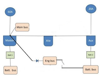

I've been considering this as well and this is the basics of what I feel has the most simplicity with adequate redundancy. Normal operation has the master switch and the engine bus feed on. In this scenario power is normally fed to the engine bus via the primary alternator/battery and in the event of a main alternator failure or master failure the backup battery/alternator will take up the load (backup regulator is set to lower voltage to prevent it from taking the load during normal ops). Engine bus is fed directly from the master solenoid (via a fuse) with a diode to prevent back feed.

Zuldarin's: Architecture is functionally the same as Bob's. The difference is feeding aux power to the engine bus via the crossfeed, rather than via a dedicated wire. Given smoke in the cockpit, the pilot will need to find and flip the aux feed switch before opening the masters. Checking backup ignition power on the runup pad will require opening a master.
I believe you are assuming that the aux bus switch is normally open? My thought was that normal operation has the aux feed switch closed so that power is available from both buses. If there is smoke in the cockpit I need only follow the normal procedure of turning off the master switch. The cross-feed switch is normally open.
Here is the actual diagram that I have been working on. Remember this is for an RV-10 which normally has the battery in the tail cone.
In this scenario I have a much smaller backup battery on the firewall. This allows me to have a reliable battery backup without having to run multiple long heavy power leads to the tailcone.
I added a relay in the main feed to the Engine bus but I want it to fail closed so I am planning on using a normally closed solenoid that is operated via a momentary switch. This allows me to test the backup power to the engine bus still have power in most failure modes.

I like the idea of using a momentary open switch to test feeds. You could have a "push to test" button that is rated for whatever current going through that alternate power path that would then test the primary path. I would be an alternate to having multiple switches to power on the aircraft power.
