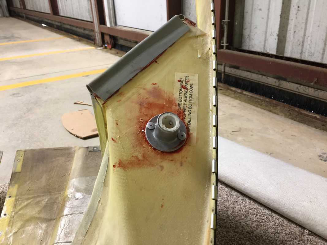

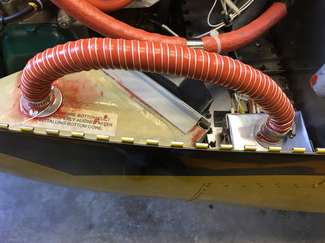

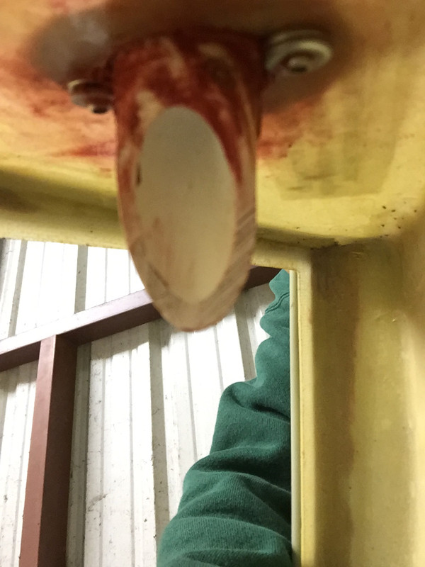

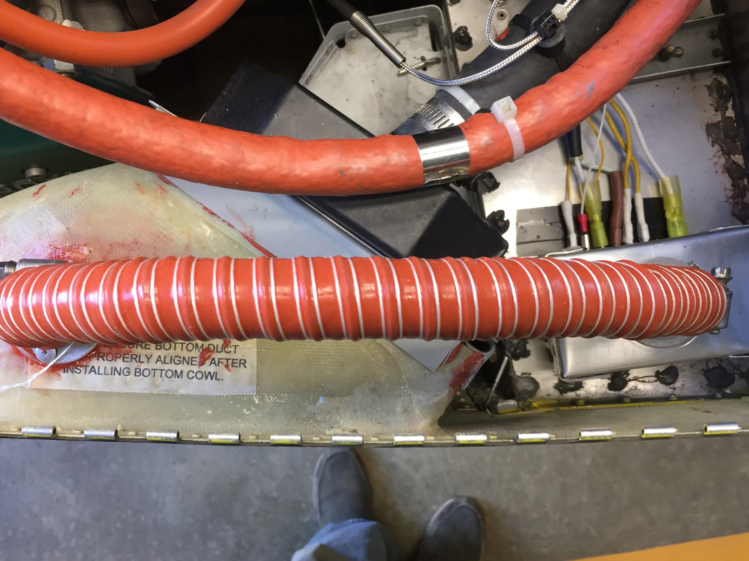

Default Modifications
I like your location and setup.
My VR was already in the engine area so I copied another person from the Vans Airforce and moved it to the left out of the airstream from the radiator and then put a blast tube to it from the airstream to the radiator. I have a thermal strip on it and when I change the oil, I will learn how hot it is getting.
I changed the oil today, 5/24/2019 and the thermal strip indicated that 135F is the highest temperature that the VR got to.
