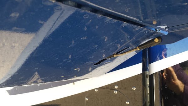

Builders with empennage kits shipped prior to 10-Jul-14 were advised on 5-Nov-14 to contact Van's for a revised E-01401AB "Elevator Trim Pushrod Parts". The text of that notice was as follows:
"Van's Aircraft has determined that the existing Elevator Trim Pushrod has insufficient length for proper RV-14 elevator trim tab movement. For builders with empennage kits received earlier than July 10th, 2014, contact Van's and request a new E-01401AB Elevator Trim Pushrod. Fabricate and install the replacement Elevator Trim Pushrod per Pages 09-12 and 09-24 in the RV-14 fuselage plans pages.
Be advised that these Plans page updates have been posted to our website on 10-17-14. Please visit www.vansaircraft.com, click on Support, then Service Information and Revisions.
This is what the original pushrod would yield. This is explained in more detail here in this blog post.
Here's a comparison of the pre 10-Jul-14 pushrod (top) with the post (bottom).
As explained in this blog post, elevator trim travel is correct with the revised trim tab.
The original N214VA demonstrator, as of 7-Aug-14, did not use the same pushrod design. The picture below is from my visit to the home base on that day, outlined in further detail here.
The adjustable push/pull rod was used during the design testing process. The standard kit supplied (fixed) push/pull rod has been installed and in use for quite a few years now.
