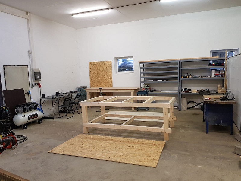

I think I'll wait for the kit to arrive and then buy the trays that I think I'll need. Stood in front of them a few times, yet, but didn't know which sizes I'd need.
Looking forward to the kit arrival. I'm currently working on my workbenches

If possible, have a bit of an overhang on the workbenches so that you can clamp to that. I like 1.5".
I use that double-sided white melamine-faced particle board that's used in cabinets for the worktops. It's smooth and reasonably hard, yet easily drilled if necessary. Easy to clean until it becomes too stained. Then just flip it over.
To let it be flipped, I make cross-pieces that fit snugly in at the ends of the frames and which are screwed to the top. They hold the top securely and the top can be lifted out easily. Flip it, relocate the cross-pieces to the new bottom and reinstall.
See this thread for the whole scheme.
