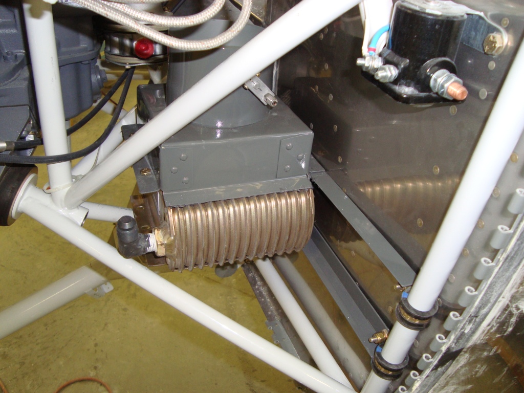

I did not use the Van's oil cooler mount. Looking at how the airflow changed direction by bouncing off the firewall, then changed direction after the cooler to conform to the exit airflow it looked like a horizontal mount would be better (photo attached). Note - the photo was taken during fit up. Final install has an adel clamp on the engine mount to the forward lip of the cooler.
If you want to stray away from stock, consider the James wheel pants.
