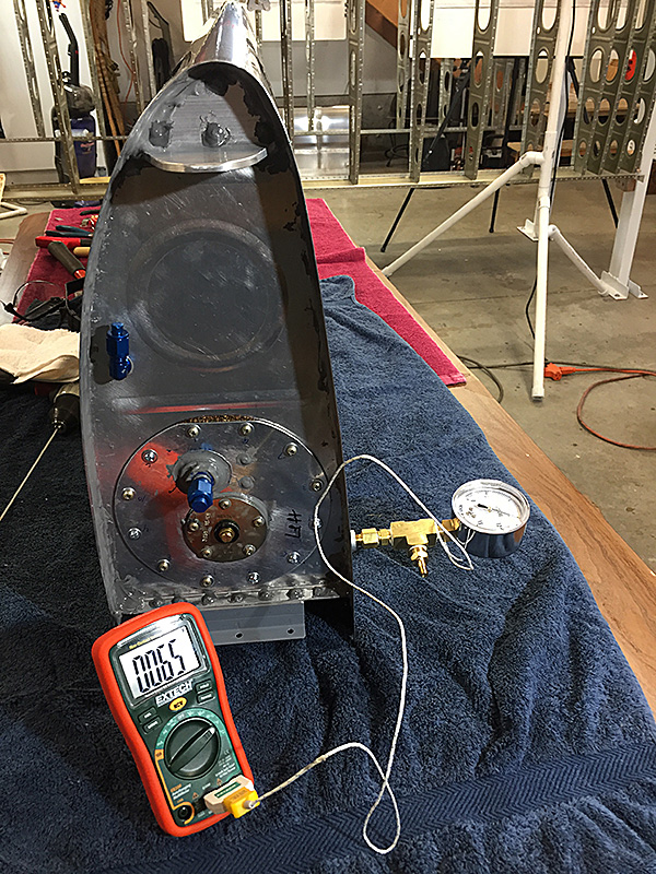

The real test is to use air and put soap bubbles on the seams.

Wink This is simple but never full proof
  1. Apply air pressure (carefully)
  2. Log gauge pressure and temperature
  3. IF temp and pressure go down (normal)
  4. If temp and pressure go up (normal)
  5. If pressure goes down and temp stays the same or goes up (leak)
Do this for most of a day or overnight.
Use snoop to verify no leaks or pinpoint leak.
Nothing in life full proof.
Forget using gasoline....sheesh

+1 for Snoop. Best thing ever. Has a little glycerin in it does a way better job than just soapy water. Get it wherever Swagelok is sold. Only about $4 a bottle.

Default Monitoring the Temp?
How do you do it? I see the parts, but don't understand the actual process.
Thx
HFS
Old 08-24-2018, 07:40 AM
Join Date: Jan 2016
Location: Los Angeles
Posts: 528
Default Pressure
Unless the temp is changing 10 s of degrees, i think local barometric pressure will have more influence. I did notice that the tank air temp and outside air temp took a few hours to find equilibrium but once everything stabilized it held for a few days this is not to be a science project unless u are into that. Manometer and soap bubbleswork well. See my blog on how i found and repaired a leak.
