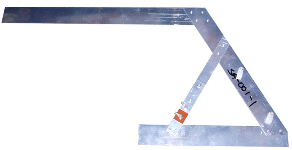

Iím converting my VFR RV7 to an IFR one. Iím looking for the best/cheapest VOR/LOC/GS antenna to install easily in my plane.
Any recommandation?

For the antenna, The archer wingtip VOR antenna is the cheapest and easiest.
I have one new in box left wing Ill sell for for $100 shipped CONUS. (SOLD)

Kahuna, Thanks for your offer, but Iím looking for an antenna which receive all VOR, LOC AND GS signals.

The above Archer antenna does receive all. VOR/LOC/GS. They work well, some up to 100 miles if installed right, and do great on an ILS approach.
I have one in my plane feeding a SL30. Follow the install directions and it will work fine,
Brian

+1 on the Archer. Mine is in the left wing and serves my 430W and SL30.
No reception issues, and not external.
