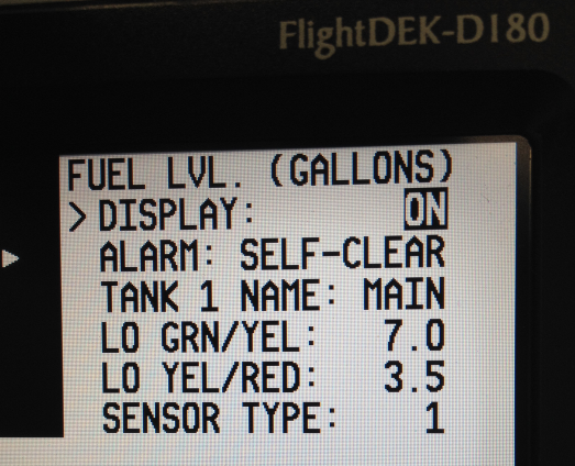

As long as we're talking fuel sensors, I'll ask a question here....
I have dual screen Dynon D180 and D100. I just recently recalibrated my fuel quantity gage in the D180 per Dynon instructions. Now I notice that I no longer get a yellow box around the digital number of gallons remaining at 7, nor do I get a red box (steady or blinking) around the digital number of gallons remaining at 4. This used to work fine and I would also get warning on bottom of screen which needed acknowledgement.
I have contacted Dynon and they tell me that the unit they have on bench does exact same thing. They were a little surprised and don't have a solution.
Anyone else experiencing this?
Your picture is for the fuel lvl alarm settings, not the fuel remaining alarm. There should be another setting. Also, your fuel computer is showing 20 gallons remaining, so no alarm should be displayed. Have no idea why the lvl alarm is not working. However, I notice there is also no arm present on the dial.
