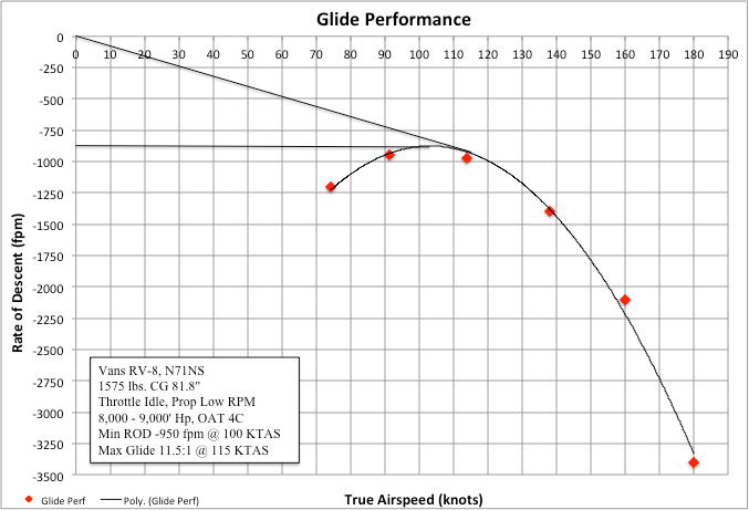

Default Here is what mine does
Here is the glide performance for my RV-8: Flaps up, Throttle idle, Prop low RPM.
Nice thing is that the top of the curve is pretty flat from 90 - 110 KTAS so if you are a little fast or slow you don't get penalized that much. I tell ForeFlight that I glide at 100 knots with a 1000 fpm descent rate and this is a little on the conservative side. When practicing I prefer to fly a little faster than min sink, this way if I slow down my situation gets better.
One thing to remember if you are trying to calculate a glide ratio is that the forward speed has to be in units of True airspeed and you have to correct the vertical speed to tapeline (i.e. take into account the change in pressure altitude caused by non standard temperature).
