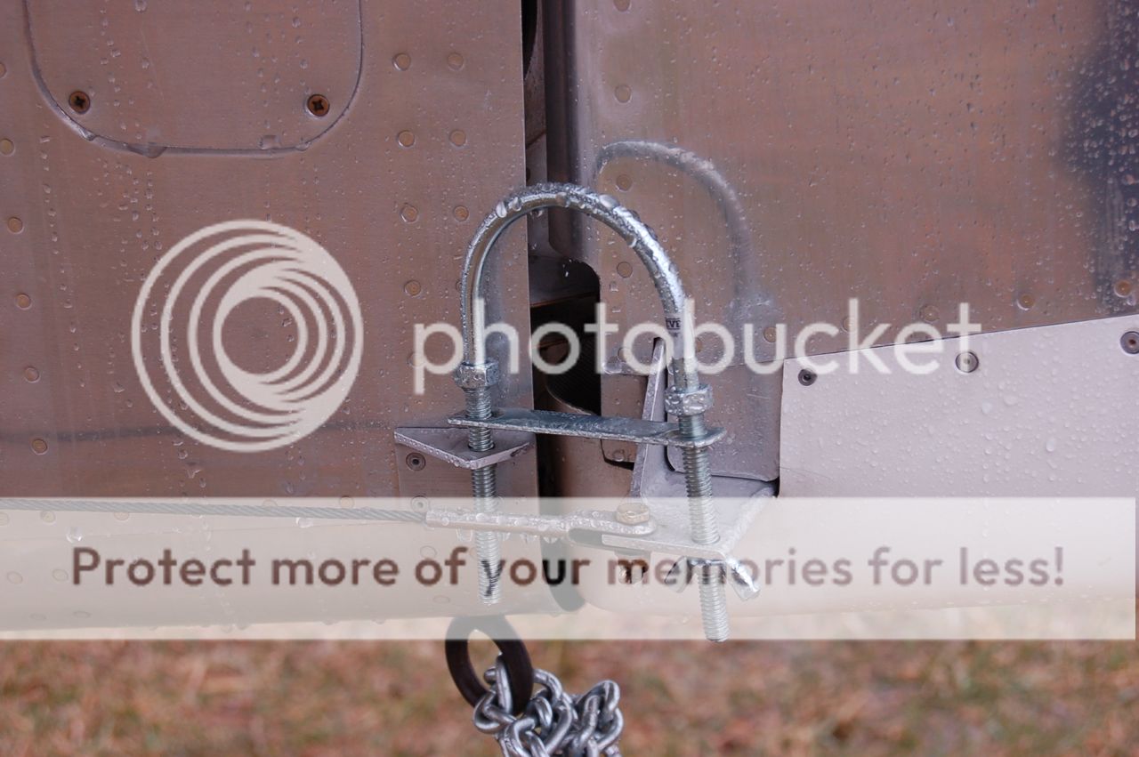

Any hardware store carry something like this
