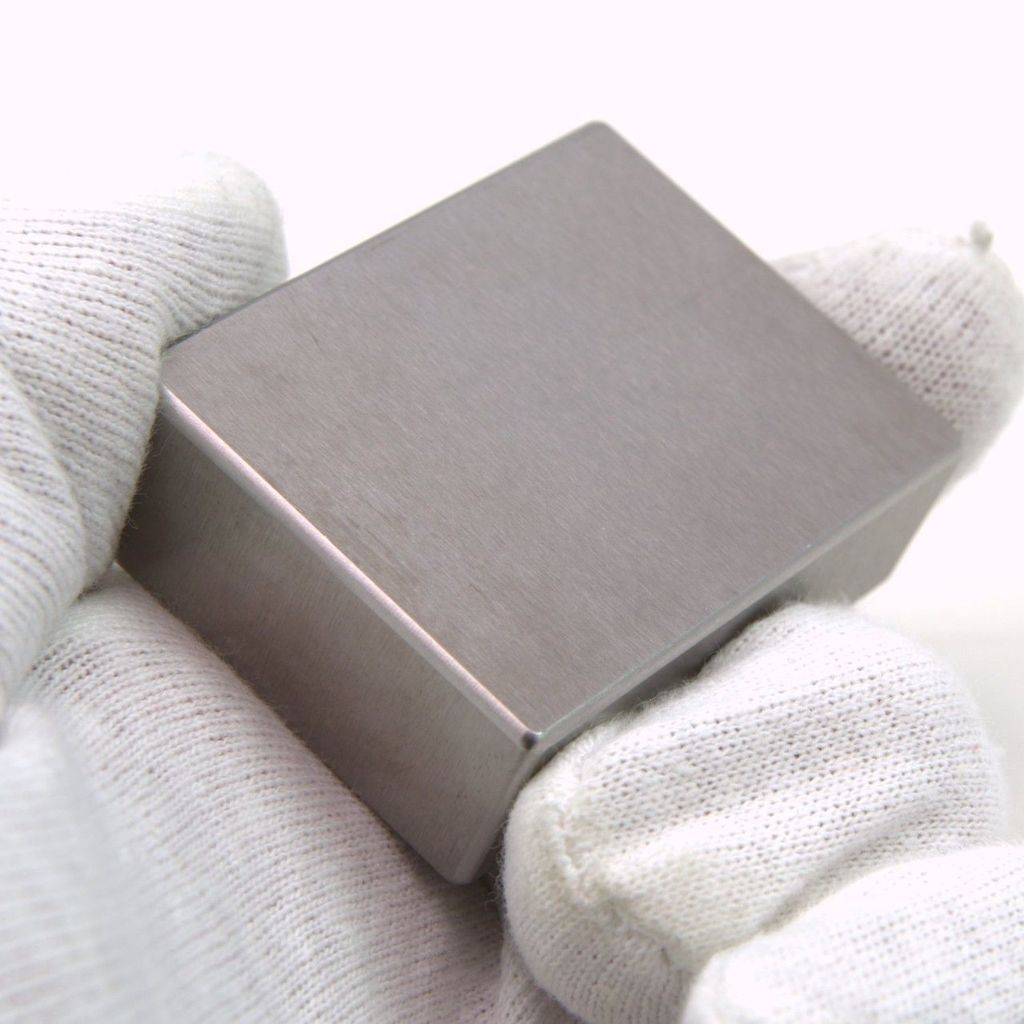

Make sure to get the one with one end angled:
http://www.cleavelandtool.com/Tungst.../#.WTeS7GddBaQ
The above one and this one below (for the 1% that the above cannot handle) are the only two ones I use:
http://www.cleavelandtool.com/Footed.../#.WTeTdmddBaQ

Thanks everyone, I will order the 4" bar!
I also found a smaller 2" x 1.5" bar. Does anyone think this would be helpful?
http://www.tungstenbuckingbars.com/d...ons/ETBB03.pdf

Blake also has an assortment of U.S. made bars.
http://www.flyboyaccessories.com/Han...ilders-s/5.htm

I received my 4" x 1"x 0.625 bucking bar today and I was blown away what a difference this makes. Not only is it easier (and a lot more comfortable) to use but the quality of the shop heads is also improved. You get a satisfying feel of the rivet tail collapsing and forming the shop head.. I want to send my steel bars to the smelter now. Thanks everyone for the recommendation!
The 4" x 1"x 0.625 bar (referred to as the snickers bar) looks like it would work for most situations, but for $70 I just ordered another bar that is 2" x 1.5" x 0.625" (referred to at the brownie bar). I think the brownie bar will be better suited to get into rib flanges. Anyone else have one of these and if so, do you find it useful?

Angled face a must have! It allows bucking in restricted spaces.
This is the one I would recommend.
I have one like it. It use to be called the "ultimate bucking bar"
http://www.flyboyaccessories.com/product-p/3204.htm

I've used this one for 99.99% of my bucking. Then I discovered that I can make any custom shape needed out of steel plate and c-clamp to the bucking bar for the really odd place. Now its my 100% bar. No need for any other bar.
http://www.tungstenbuckingbars.com/d...ons/ETBB13.pdf
