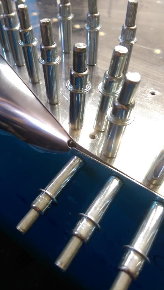

Originally Posted by rapid_ascent View Post
I was super worried about mine, but I deburred fully and did it according to the plans. I seemed to work out fine. One thing I would say is that it might be helpful to have a small radius on the piece that you clamp down. You will be bending around that piece and you don't want a sharp corner. I used a large crescent wrench to get enough torque for bending. Just go a little bit at a time. This material is tougher than you might think so it does take some effort to make the bend and it's hard to do just a little more due to the material wanting to spring back. Just don't get in a rush and it will come out fine.
Agreed. The 1" square tube I used has about .1875 radius, .250 or .375 would have been better. This is a close up of the tight bend point on mine.

Originally Posted by RVdreamin View Post
That looks great! Will you be vacationing in Florida anytime soon 😁
I don't think so...lol, but, I just set the crescent wrench in the middle, to begin with then moved it down to the tight side reefed on it, then moved it back up and reefed on it some more. I went past the 90 point by a good 20% to get it to settle at the 70 degree or so point I was left with.
