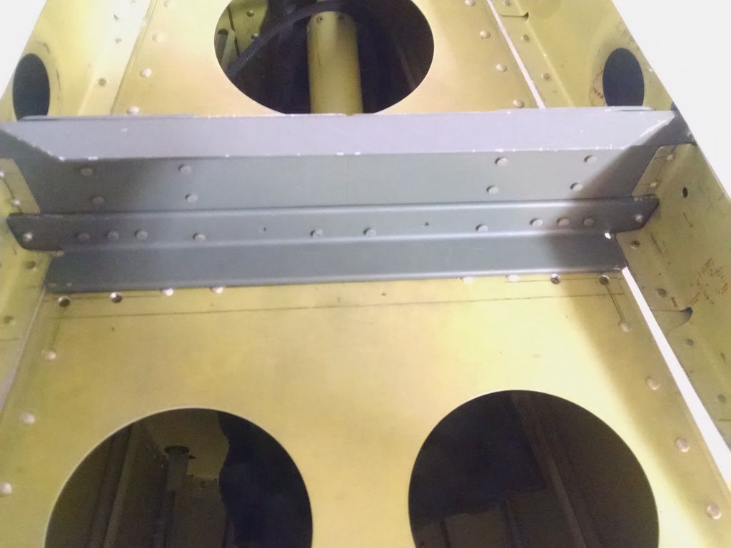

Guys: Looking for some ideas/suggestions/help in match drilling the holes in the HS-714 angle, that was installed during the horz stab SB, with the previously located and drilled longeron holes, as they existed with the old angle, before the horz stab SB.
It's too tight of a space to crawl back there so, I'm thinking maybe a strap duplicator or.....?
Figured I'm not the first one that has had to do this.

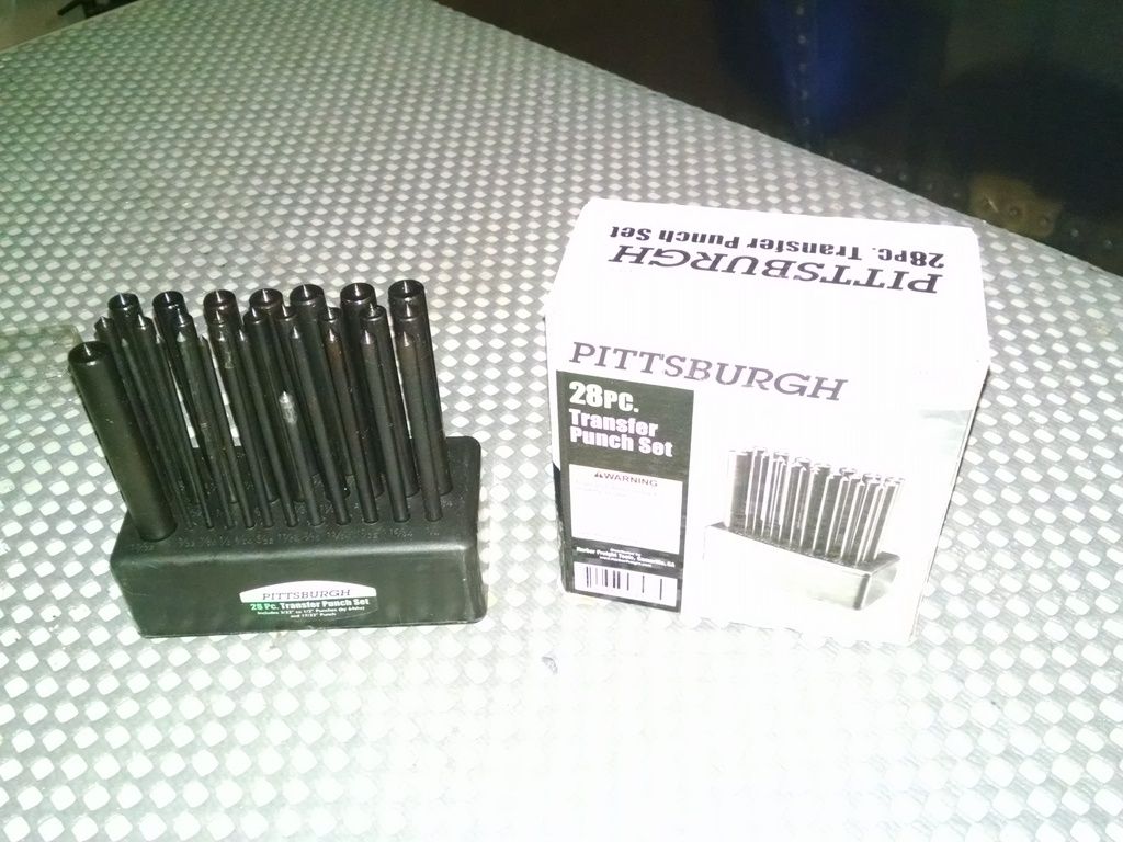

To wrap this up for anyone faced with a similar challenge; Considered the options offered here but, continued to search the google for ways to drill holes that couldn't be seen and ran across tools called "Transfer Punches". Located an assortment of these punches at Harbor Freight for $10.

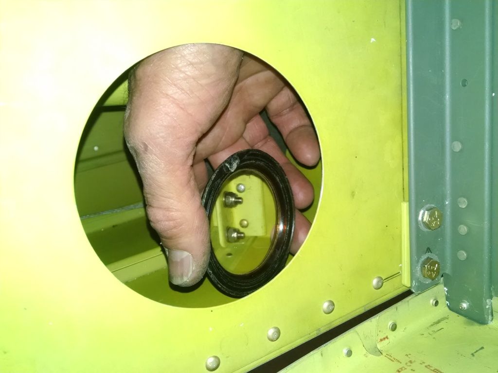

Was able to mount and square the horz stab, clamp it in place, reach under thru lightning holes, inserted 3/16 inch punch thru the angle piece as well as the spacers, allowing for a fairly wobble free insertion. Gave the punch a wack with a bucking bar, removed the stab and witnessed the centered punch mark.
