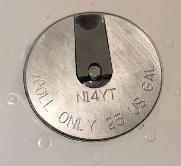

Hey All, it's a great day for showing off something new that I've been waiting for...
Aerosport Products is the place that did that did the machined, engraved, aluminum tops to replace the "el' cheapo" looking plastic tops of your fuel caps. http://www.aerosportproducts.com/about.htm
I received my set of aluminum tops yesterday and they fit perfectly!
Note: You replace just the tops of your old fuel caps, keeping all of the other parts. The new caps they are planning to have pre-engraved with "100 LL only 25 US Gal" to help you comply with marking requirements for your inspection. The N-Number engraving I had done is extra, because that will require the fuel caps to be taken back for machining and a machine setup would be required for that. You'll want to talk to Aerosport for the details.
Geoff didn't tell me to do this but... if you have interest in them, maybe give them a call or email just to let them know. It may be nice for them to get an idea of how many people may be wanting them before they fire up for a production run. It could prevent delays in the event that there are many.
I'm very happy with how they turned out. They look so much better than the plastic, and maybe now they won't blow off my wings when I'm fueling up. I'm going to keep them unpainted, especially since they are engraved.
The engraving of the N-Number is a nice touch. If you ever lose a fuel cap, maybe the finder will have a way to track your address down and send it back to you.

Looks good Tim, I was planning on purchasing a spare plastic one incase I lost one, now I will probably give Geoff a call. Have you tested them in a roll to see if they are tight yet?

Hey Ron,
No, I haven't rolled with them yet. Maybe this week if I can get out of work.
I miss Daylight saving's time. It gets dark too early after work these days.
I don't expect any issues, because the stem seal doesn't fit inside a real capture groove on them around the stem (on either the plastic or aluminum). So they should seal the same as the original. The o-ring groove for the big o-ring is also identical and fits nicely. So if they leak it'll just mean I have to tighten the nut again like I did on the plastic ones. One day I'll have to measure up for o-ring sizes so that I can keep a couple of o-ring spares for the caps on hand. If I find some that are right, I'll post it here. It would be a good idea for us all to have spare o-rings handy over the years. I'll look for viton ones. I'm also going to get some replacement nuts. I haven't sized them yet but I believe they are probably metric. Wouldn't hurt to have spare nylock nuts on hand.
I'd be careful with that marking, especially since it would be engraved and not easily changeable. If an unleaded avgas ever comes along I think you'd technically be violating your placards by using it. And anyone running mogas would also technically be violating it.
IMHO a better marking would be "XX gal XXX min octane" or something like that.

Hey Ron,
Yesterday I did get a chance to roll test the new caps, with full fuel tanks and only me aboard. No leakage at all. Very happy now. It was a windy day too, and they didn't blow off the wing anymore.
