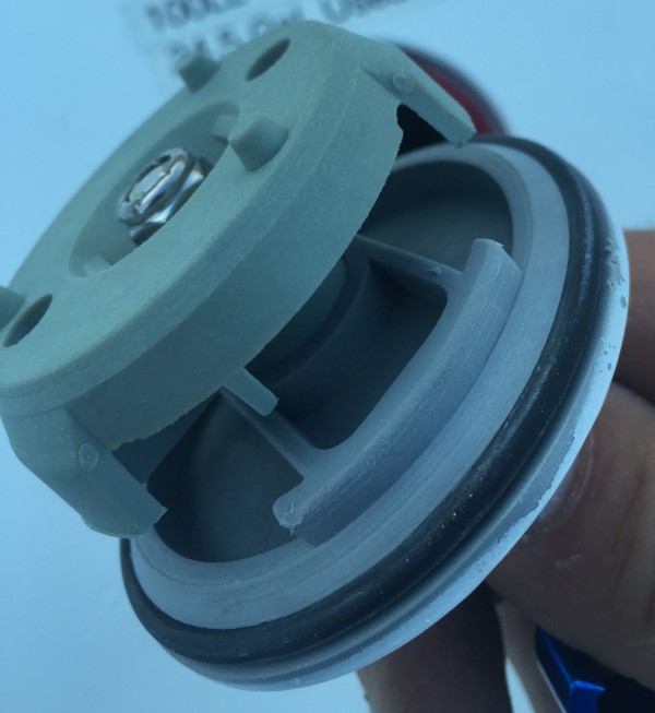

Attached you can see pics of my fuel caps, and the mechanism that is being described. I agree that in general the fuel caps are a better design (as long as these can be sealed tight). I just think the material chosen is a poor choice.
I'd prefer a nice aluminum cap, and then engrave them. It does appear that these are engraveable. It looks like Aircraft Specialty does them:
http://www.aircraftspecialty.com/engraving.html
These are the SPRL caps. I'll have to see what info I can find on them. I'm not going to stop and tear mine apart right now, but if I could have a new top machined I'd do it. For the time being, I may have to buy new caps if I can't strip off my paint. Below are the pictures of my caps. I would recommend NOT painting them if you're using these caps....at least not unless you have a better paint to use for the job. Remember, mine has been flying less than 2 weeks and if they look like this now they're going to be downright ugly in a year or two.

We have that cap on our Europa. Over ten years now with no problems. We disassemble and lube the orings every year. Be sure to lube the small one on the shaft. We park outside several weeks each summer and no problems with rain leaking into the tank. The orings are metric but available from McMaster.

Do you see the SS locknut on the bottom of the cap? This sets the 'squish' on the O ring. Sounds like yours are a bit loose - tighten slightly until you get the seal you want. I thought Robin had a locking metal replacement version, but I don't see it on his website now.

I did tighten mine and also lubed them, and they don't leak much if at all anymore, so that is good. I'm still left wanting aluminum, however, for the many reasons I gave. They will look much better as well. At least the plastic ones are useable the way they are.
