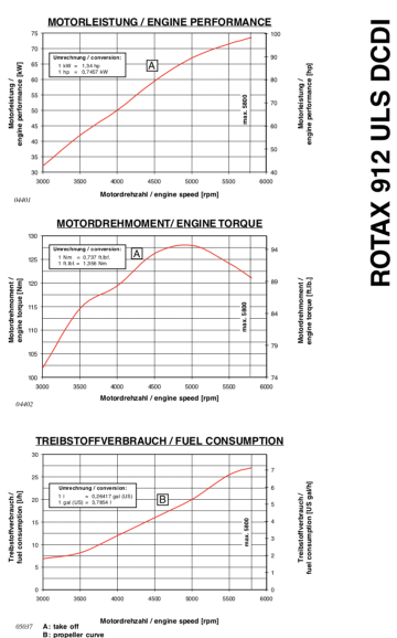

Here are a few data points…
Shoot for 5100/5200 RPM in initial climb. My field elevation is 800MSL.
One person w/ half fuel = 1100+ FPM initial climb.
Prop pitched per above should yield 110 knots at 3000 MSL and 5500 RPM.
Cruise flight at 5500RPM should have throttle positioned about 1” pulled out from full throttle.
My fuel burn per above is right around 6 GPH, which pretty much agrees with published Rotax specs.
No fun having an airplane if your not going to go fast…
Another data point... E9310 at Costco is $2.12/Gal today.
https://www.rotaxservice.com/wp-cont...5/912Sperf.pdf
