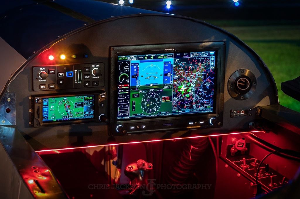

Ask away regarding Garmin IFR installs. I'm adding a G5 as a backup in a week (it will be installed where the airvent is in this picture) and then the heated pitot in January.[IMG][/IMG]

Just curious how the structural cross member was handled on the above panel, looks the audio panel and maybe the 650 as well would interfere with it.

It appears from Devin's pic that a G3x can go in the center of the panel and still install a GTN 625/or 650 if you want to start out VFR . Stein company informs me a high percentage of new installs are equipping for GPS only approach ( GTN625).
What say you ? Would you buy an RV with G3x and remote (autopilot/com/transponder ) for GPS only approaches ?
I personally like the option to fly an ILS or a Localizer approach although, realistically I prefer to fly the RNAV regardless. One piece of advice I would highly recommend is a decent redudnent system for a backup. I did a certified aircraft grade install with a local avionics shop overseeing my work. They reminded me that the extra $1500 for a G5 and a backup battery is a MUST. Right now (I have not filed actual yet in the plane) if I were in the clouds and had a complete electrical failure I would only have an iPad. That G5 may someday save your life. Just my two cents.
i know, the wings are going to fall off and im going to die because i changed the design, but on mine i replaced that part with a piece of 3/4 X 3/4 X .063 angle.
but then, my panel is standard size, not oversized, so i placed it with the flat side right at the bottom of the panel. that made the whole panel usable.
