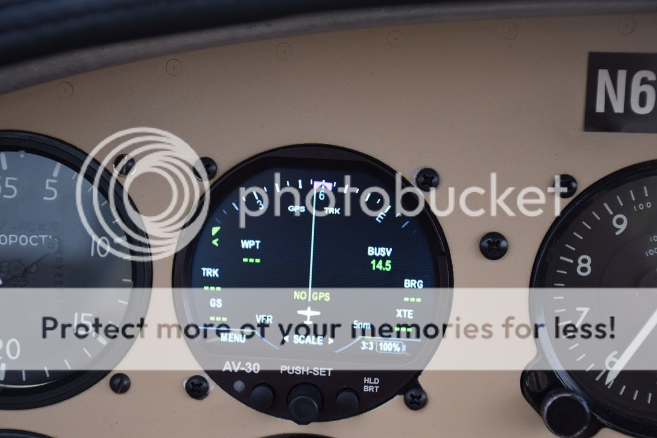

Just a quick Pirep: Ive only flown with the AV-30 for an hour, but am really impressed! The install was very easy. Configuration took 10minutes to tweak everything just right for my aircraft in level flight. Very easy menu.
The picture doesn’t do this AV-30 justice. This unit is pretty stunning. I think it’s the 3-D ‘shading’ that really makes this thing pop. It makes my TruTrak look washed out and dull in comparison.
This thing certainly handles aerobatics better than any AI I’ve flown before. For just 31/8” space, it really packs a lot of easily readable info. I very much like the distance to next GPS destination displayed. Always a pain looking over and trying to read my Garmin 300XL. Also, I had the unit on backup battery for 5 minutes on the ground; the backup battery status still showed 100%. Far from a 2-hr test, but not bad��
I’m now Vacuum free. It was nice to yank out all of the old vacuum hoses and hardware.

About 15 hours behind it now. I'm still impressed with the form factor. My favorite page setup has next GPS waypoint and distance on the screen. No more squinting at my monochromatic Garmin 300XL to find the info Auto-dimming works well at night as well. So far, so good.
