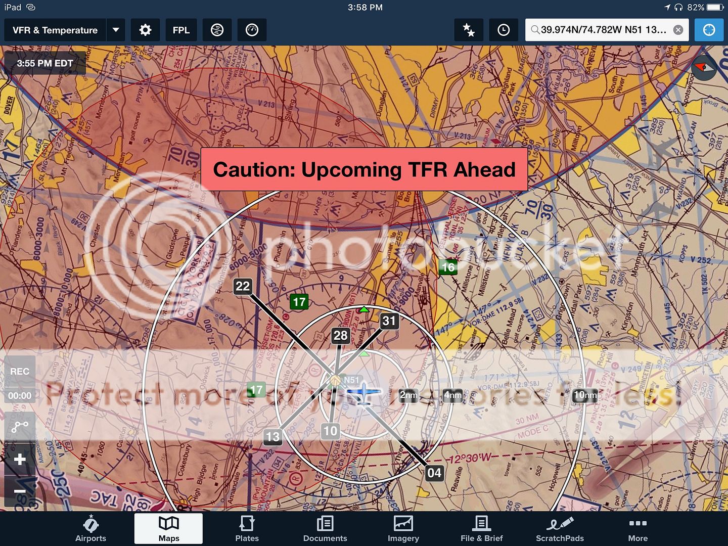

As I was flying today the POTUS TFR looked quite odd. Here a picture of when I was heading back into it:
See the triangle in the middle which is not colored red. Looked like that all day long. It's clearly wrong as the TFR was it's usual 30 mile circle. Wonder if that is a Dynon or ADS-B issue. Either way I guess it can not be trusted... .
Oliver

Oliver,
If you have a datalog for that flight (a "Dynon Diagnostic Log") we can look at it and see if the FAA sent something odd or if we interpreted it incorrectly.
The data would be in there as long as you haven't flown more than an hour since you last saw this.
