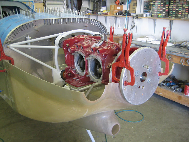

I use this tool to cut in a Cowl.

Another pic of Cowl Tool
this is an 0-360
this is an 0-320
there is no difference in engine size either can do the job of the other. I have a 360 and a 320 engine block.the red one is 360 and the gray one is 320

This makes it easer.

My Cowl Tool makes the cowling easy.

This tool makes fitting a cowl pretty easy. I start with the bottom. Cut to the lower firewall. Next fit the sides. Once drilled and clecoed. Start fitting the top cowl.
