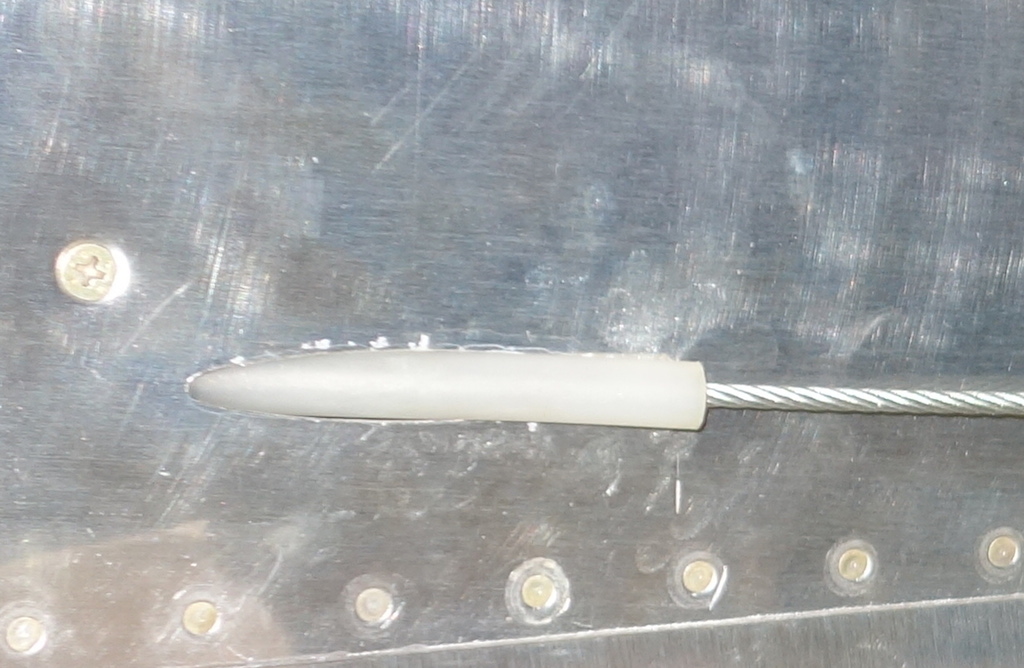

Hi Vlad - here is what is on my RV-8 ...
- Glen, ESVA

"AVERY", the only thing I should add is we put a peace of nylon tube around the cable and then put the cover over it to hold it in place. This will save you having the cable rub on the metal. Hope this helps. Yours as always R.E.A. III #80888

Vlad, I used the ones Avery sells but installed them on the inside. Just make the hole a little larger and stick the fairing out thru the hole, countersink the rivets and apply a little fill around the fairing and it makes a smooth transition. No flanges seen on the outside.

I cut and shaped the Avery covers. Yes, I used pop rivets... shame on me.

Here is another angle that shows the nylon sleeve inside the faring ...
- Glen, ESVA
