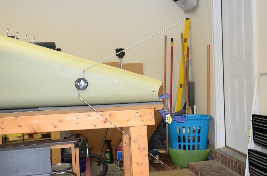

We finished the vertical stab, rudder, horizontal stab, and elevators+trim tab .. started on the tail cone this weekend .. but dropped the bucking bar during a rivet and trashed the bottom skin .. ugh .. this hobby needs a therapy hotline!

Yea, just got the shipping quote, ouch! Now it's a $200 mistake.
I'm sure a painter can fix it but it's pretty bad. I'm used to smileys here and there but this is about 1/4 deep and about 2 inches long. It will have my OCD on overdrive. Can't live with it, already removed the rivets.
