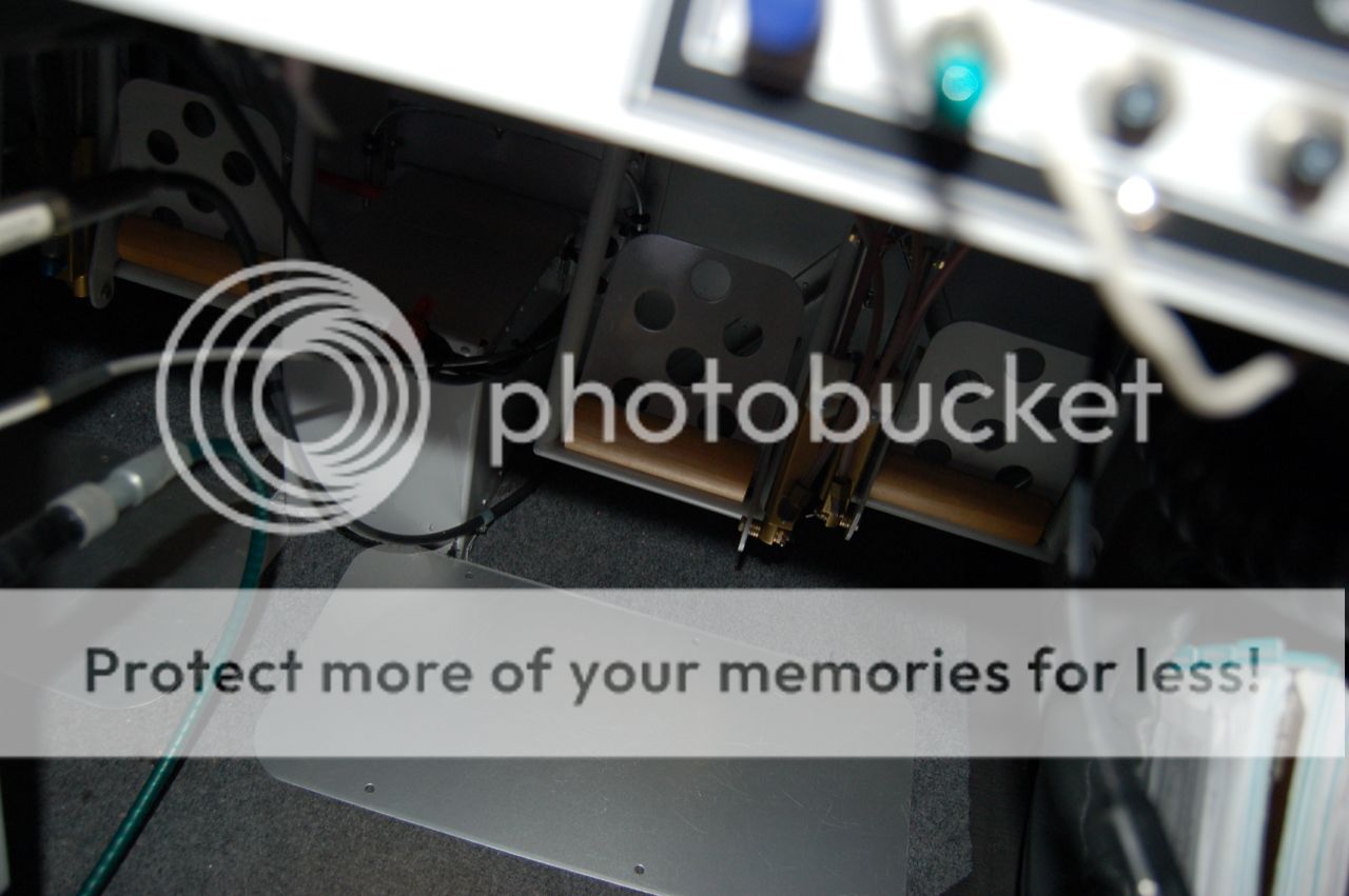

I built a carbon fiber box to hide my fuel pump/filter, cover a PC680 battery, provide some tool storage and glove box, and mount my O2 bottle. When I've got the bottle installed, I put my cannulae in there. If I don't need the bottle for a flight, I save 12 pounds and leave it behind. When baggage is heavily loaded, the bottle helps to keep the CG in limits.
I even put a little led light in there for glove box searching.
Ed Holyoke

Ed,
Thanks. I think what you show there is similar to what I was thinking, and may be like what Ralph was describing.
Hate to pepper with questions, but how tall is your box? If you had to do it over again, would you do it any different?

Howdy,
I think it's about 9 or 10" tall. I sized it based on where my O2 bottle wanted to be, clear of the rudder pedal crossbars. Mine is slightly angled up coming aft from the firewall to put the o2 regulator in a better position for inflight access. If you're not putting a bottle on top of it, it could easily be taller. I have a battery on its side just behind the firewall. I put some of my tools in zipper bags with zip ties hanging out of them so that I can retrieve them when they are shoved all the way forward on top of the battery leaving room behind for more stuff. The assembly is about as wide as it could be which seemed a little restrictive for pilot/co-pilots' legs at first. I got used to it. It wound up that wide to cover the battery and allow for the fuel line and return from purge valve to the firewall. Try mocking it up a little narrower and see if it meets your needs. I made it out of sheets of carbon fiber layed up over some hex core material and vacuum bagged on a flat bench. Once I had the material, I basically just treated it like sheet metal. I put it all together with hinges so I can get in the maintain the battery and the fuel pump/filter assembly. I wound up removing the left side and installing a vertical hinge in it to make it easier to get to the fuel filter during my second annual.
Ed Holyoke

Ed,
Thank you for the extra detail. Great to hear from a been-there-done-that person.
