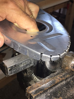

These are my wing ribs all deburred.
The two yellow spools are the sandpaper I used for deburring the holes and flange edges. I also used just a loose sheet of 220 grit pinched between my fingers for the long straight flanges. The abrasive spools were a 1/16" rope and a 1/4" flat ribbon. This worked really well. I probably used 25% of a 25 foot roll. Many of the rib flanges were fairly well deburred already, so it didn't take much more for me to be satisfied. The lightening holes needed the most effort.
I also built the rib flange forming thing-a-ma-gig sitting on the table. It forms the flanges to the perfect 90 degrees to the rib web. It works very well. However, when I tried it out, I grabbed a nose rib and looked at the flange. It measured almost perfect without me having to touch it. Then I looked at the center rib, seems perfect too. Did I spend half a day and $20 on this thing for nothing? I will finish up checking the flange angles tonight. But I will probably be too embarrassed to tell anyone how useful, or useless, this tool was. It is well worth the effort to construct for the flanges on the tail ribs, wish I had it then. But I hope I never have to rebuild the tail feathers. I am very grateful Vans aligned the flanges on these ribs; saved a ton of work.
Also in the picture are the mods I plan to make to the ribs. I talked to Van's Aircraft support on Friday and they said what I had planned seemed reasonable. If you wish to follow my example, please check with Van's yourself. So here is my plan: for the nose rib, I will enlarge the internal fuel vent hole from 1/4" to 1/2". (This is not the hole the vent tube goes thru, but the one that will be at the high point when filling the tanks.) The stock hole seems really small to me, and others have complained the tanks are slow to fill. I don't plan on doing aerobatics, nor uncoordinated flight (who does?), so I am not worried if these enlarged holes cause the fuel to slosh around a little more. For the main rib, I plan to follow the supplemental instructions on the Van's Aircraft site and add a hole in the main web to the right of the first lightening hole in the picture. This will be 3/4" per the supplemental instructions. Also the RV9 plans say it is permissible to enlarge the forward tooling hole to 1/2". But the same Van's supplement says the RV7 and 8 can enlarge this to 5/8". I will follow the 9 plans and only enlarge to 1/2 ".
Lastly in the picture, behind the table, are the wings stands for the spars. I plan to build both wings at once. These stands are a God send. Thank you to the builder Billy who provided them.
So that is my plan. Onward and upward, (well not yet anyway) :-(

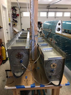

Default Fuel Tanks- Didnt Hold My Breath Long Enough
Last report, I was holding my breath the fuel tanks would not leak.
Like all good learning experiences, my tanks leaked; both of them, mainly from the rear seam.
The one tank leaked from the seam near the fuel sender and access hole. This was easy enough to fix by removing the access panel and adding more goop.
The tank in the picture leaked from the top seam near the middle, in 2 places. Ugh.
There were many options I found on-line to fix this:
1) use Loctite adhesive designed for just such a repair.
2) ignore it and hope it goes away.
3) cut a hole in the baffle, add more sealant and then use a new access plate to cover over hole.
4) use the really thin Proseal that is brushable, pour it in the tank and slosh it along the seam.
5) make a funky applicator with a syringe and tubing; using a USB camera, and add some more Proseal to the seam thru the filler neck or the sender access panel.
Of course, being the expert builder that I am, I did none of the above.
I decided to use option 6), which is not listed above. If that didnt work, use option 3.
Option 6) was to drill out the baffle rivets in the offending area, wrap a towel around the vacuum cleaner nozzle and tape it to the fuel filler spout. With the manometer hooked up, turn on the suction and leave the fuel sender screws out to avoid over pressurizing the tank (wouldn't this be under pressurizing?). Add some Proseal to the seam, and gently open the seam up by gently flexing the tank skin. To my surprise, the sealant sucked itself into the gap. I used a heat gun to gently heat the tank skin to help the Proseal flow into the cracks. The whole time the tank was under 27" of vacuum.
After resetting the rivets, I let the tank sit for a day. I started the pressure test tonight, and the leak check using soap bubbles showed no leakage. Normally I would say done, but I plan to let it sit over night just to make sure.
