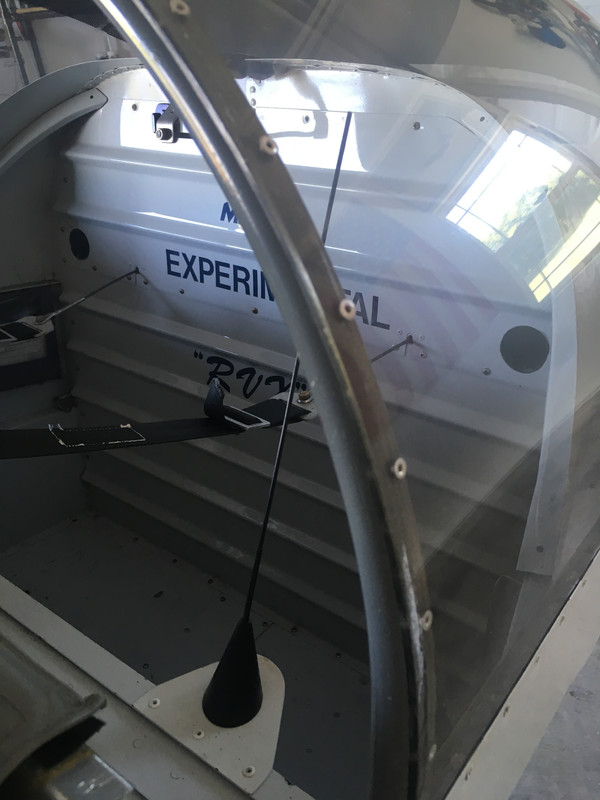

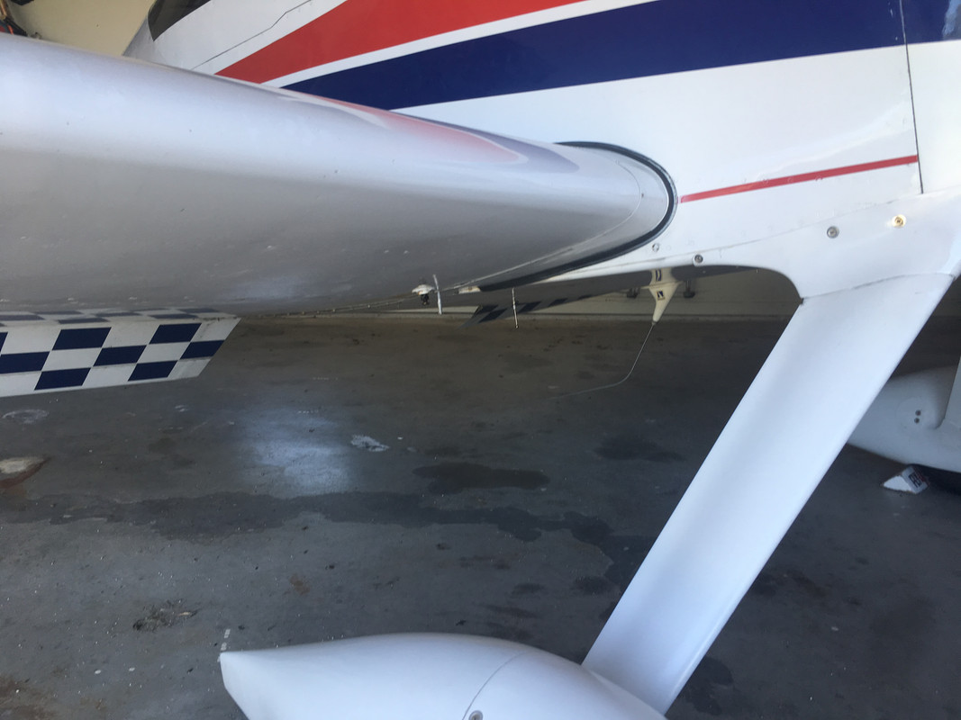

That said, as mentioned above, GPS antennas can be mounted inside, on glare shield, a shelf in back, under cowling out front, etc. I never mounted my ELT antenna externally on my RV4, HR2 or RV6"X" as it works great inside and is one less drag coefficient and less "ugly". I mounted my RV6"X" Comm antenna on the belly between the gear legs as its a bit less drag but mainly it's more aesthetically pleasing IMHO.
On my RV4 I mounted my GPS antenna under the canopy, my Bob Archer Comm antenna inside the left wingtip, my transponder antenna inside the other wingtip therefore making it a complete, inside job.
Good luck!
V/R
Smokey
RV6-X Comm
